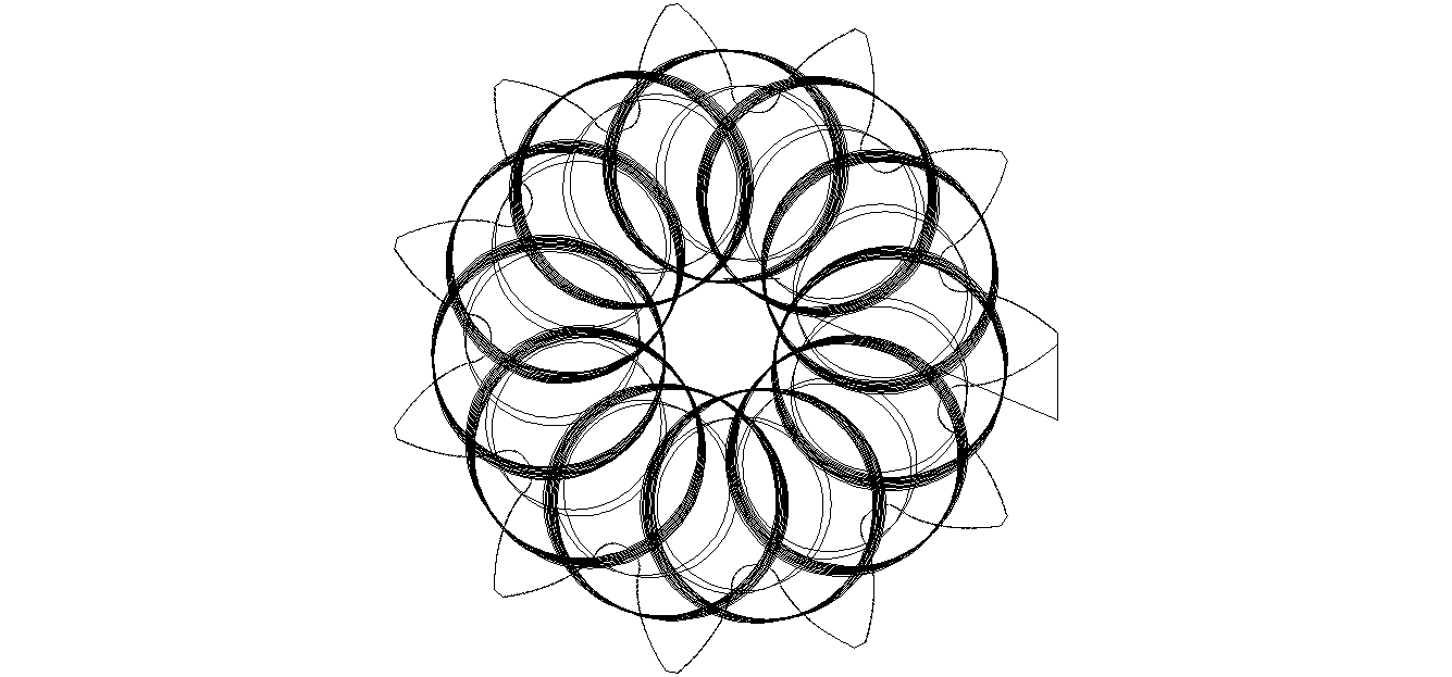

试了一下,画出以上简单程序的AUTOCAD图还准确.画出复杂齿轮程序的AUTOCAD图完全不正确.

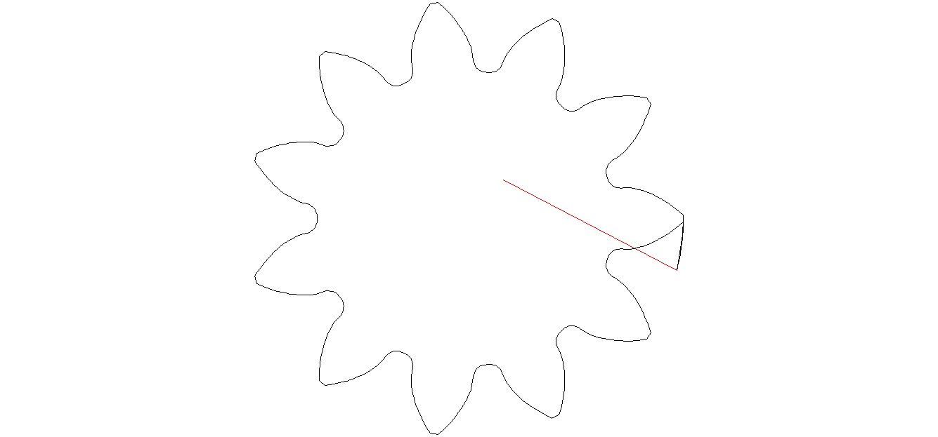

发表于 2010-6-12 20:36 | 显示全部楼层
watch.rar (6.87 KB, 下载次数: 11)
画齿轮图不正确
gearcheck.rar (101.12 KB, 下载次数: 15)

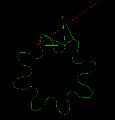

 楼主| 发表于 2010-6-12 21:51 | 显示全部楼层
CamWorks2010生成的G代码,能正确显示的呀:o

X.1335 Y-.2863 I-.0404 J.081
X.1381 Y-.2835 I-.0518 J.092
X.1432 Y-.2801 I-.0645 J.102
X.1488 Y-.276 I-.0783 J.1108
X.1547 Y-.2711 I-.0931 J.1186
X.1609 Y-.2654 I-.1089 J.1251
X.1674 Y-.2588 I-.1256 J.1302
X.174 Y-.2513 I-.1431 J.1339
X.1807 Y-.243 I-.1612 J.1362
X.1875 Y-.2336 I-.1799 J.137
X.1941 Y-.2233 I-.1991 J.1361
X.1989 Y-.2152 I-.2187 J.1337
X.1826 Y-.1759 I-.3714 J-.1308
X.1735 Y-.1735 I-.0691 J-.2468
X.1615 Y-.1709 I-.0566 J-.2345
X.1501 Y-.1691 I-.0418 J-.2222
X.1394 Y-.1679 I-.0284 J-.2091
X.1295 Y-.1673 I-.0164 J-.1953
X.1203 Y-.1673 I-.006 J-.1808
X.1118 Y-.1676 I.003 J-.1658
X.1042 Y-.1684 I.0104 J-.1504
X.0974 Y-.1694 I.0162 J-.1347
X.0913 Y-.1706 I.0205 J-.1189
X.0861 Y-.1719 I.0232 J-.103
X.0817 Y-.1732 I.0243 J-.0872
X.0781 Y-.1745 I.0239 J-.0715
X.0753 Y-.1757 I.022 J-.0562
G01 X.075 Y-.1759
G02 X.0543 Y-.1957 I-.085 J.0679
X.0403 Y-.204 I-.0508 J.0693
X.0041 Y-.2086 I-.0244 J.0484
X-.0148 Y-.1976 I.0105 J.0398
G03 X-.024 Y-.1883 I-.1577 J-.1484
G02 X-.0351 Y-.1694 I.0288 J.0294
X-.0305 Y-.1332 I.0529 J.0118
X-.0222 Y-.1192 I.0777 J-.0368
X-.0024 Y-.0985 I.0877 J-.0644
G01 X-.0022 Y-.0982
G03 X-.001 Y-.0954 I-.055 J.0249
X.0003 Y-.0918 I-.0702 J.0276
X.0016 Y-.0874 I-.0858 J.0287
X.003 Y-.0822 I-.1017 J.0284
X.0042 Y-.0761 I-.1177 J.0265
X.0052 Y-.0693 I-.1337 J.023
X.0059 Y-.0617 I-.1497 J.018
X.0062 Y-.0532 I-.1655 J.0114
X.0062 Y-.044 I-.1809 J.0032
X.0056 Y-.0341 I-.1959 J-.0065
X.0044 Y-.0234 I-.2103 J-.0177
X.0026 Y-.012 I-.2241 J-.0304
X0. Y0. I-.2371 J-.0445
X-.0024 Y.0091 I-.2491 J-.0601
X-.0417 Y.0254 I-.1701 J-.355
X-.0498 Y.0206 I.1256 J-.2234
A0 H0
G01 G40 X-.1801 Y.2339
T85
M99
N7001
G41 A0 H0
G01 X-.0498 Y.0206
H1
G02 X-.0417 Y.0254 I.1337 J-.2187
X-.0024 Y.0091 I-.1308 J-.3714
X0. Y0. I-.2468 J-.0691
X.0026 Y-.012 I-.2345 J-.0566
X.0044 Y-.0234 I-.2222 J-.0418
X.0056 Y-.0341 I-.2091 J-.0284
X.0062 Y-.044 I-.1953 J-.0164
X.0062 Y-.0532 I-.1808 J-.006
X.0059 Y-.0617 I-.1658 J.003
X.0052 Y-.0693 I-.1504 J.0104
X.0042 Y-.0761 I-.1347 J.0162
X.003 Y-.0822 I-.1189 J.0205
X.0016 Y-.0874 I-.103 J.0232
X.0003 Y-.0918 I-.0872 J.0243
X-.001 Y-.0954 I-.0715 J.0239
X-.0022 Y-.0982 I-.0562 J.022
G01 X-.0024 Y-.0985
G03 X-.0222 Y-.1192 I.0679 J-.085
X-.0305 Y-.1332 I.0693 J-.0508
X-.0351 Y-.1694 I.0484 J-.0244
X-.024 Y-.1883 I.0398 J.0105
G02 X-.0148 Y-.1976 I-.1484 J-.1577
G03 X.0041 Y-.2086 I.0294 J.0288
X.0403 Y-.204 I.0118 J.0529
X.0543 Y-.1957 I-.0368 J.0777
X.075 Y-.1759 I-.0644 J.0877
G01 X.0753 Y-.1757
G02 X.0781 Y-.1745 I.0249 J-.055
X.0817 Y-.1732 I.0276 J-.0702
X.0861 Y-.1719 I.0287 J-.0858
X.0913 Y-.1706 I.0284 J-.1017
X.0974 Y-.1694 I.0265 J-.1177
X.1042 Y-.1684 I.023 J-.1337
X.1118 Y-.1676 I.018 J-.1497
X.1203 Y-.1673 I.0114 J-.1655
X.1295 Y-.1673 I.0032 J-.1809
X.1394 Y-.1679 I-.0065 J-.1959
X.1501 Y-.1691 I-.0177 J-.2103
X.1615 Y-.1709 I-.0304 J-.2241
X.1735 Y-.1735 I-.0445 J-.2371
X.1826 Y-.1759 I-.0601 J-.2491
X.1989 Y-.2152 I-.355 J-.1701
X.1941 Y-.2233 I-.2234 J.1256
X.1875 Y-.2336 I-.2058 J.1258
X.1807 Y-.243 I-.1867 J.1276
X.174 Y-.2513 I-.168 J.1278
X.1674 Y-.2588 I-.1497 J.1265
X.1609 Y-.2654 I-.1321 J.1236
X.1547 Y-.2711 I-.1152 J.1193
X.1488 Y-.276 I-.099 J.1137
X.1432 Y-.2801 I-.0838 J.1067
X.1381 Y-.2835 I-.0696 J.0985
X.1335 Y-.2863 I-.0564 J.0892
X.1294 Y-.2884 I-.0444 J.0788
X.126 Y-.29 I-.0337 J.0675
X.1231 Y-.2912 I-.0242 J.0553
G01 X.1228 Y-.2913
G03 X.0942 Y-.2919 I-.0121 J-.1081
X.0783 Y-.2959 I.0131 J-.085
X.0495 Y-.3183 I.0169 J-.0515
X.044 Y-.3395 I.0356 J-.0207
G02 Y-.3525 I-.2164 J-.0065
G03 X.0495 Y-.3737 I.0412 J-.0004
X.0783 Y-.3961 I.0457 J.029
X.0942 Y-.4001 I.0289 J.0809
X.1228 Y-.4007 I.0165 J.1075
G01 X.1231 Y-.4008
G02 X.126 Y-.4019 I-.0213 J-.0565
X.1294 Y-.4036 I-.0302 J-.0691
X.1335 Y-.4057 I-.0404 J-.081
X.1381 Y-.4085 I-.0518 J-.092
X.1432 Y-.4119 I-.0645 J-.102
X.1488 Y-.416 I-.0783 J-.1108
X.1547 Y-.4209 I-.0931 J-.1186
X.1609 Y-.4266 I-.1089 J-.1251
X.1674 Y-.4332 I-.1256 J-.1302
X.174 Y-.4406 I-.1431 J-.1339
X.1807 Y-.449 I-.1612 J-.1362
X.1875 Y-.4584 I-.1799 J-.137
X.1941 Y-.4687 I-.1991 J-.1361
X.1989 Y-.4768 I-.2187 J-.1337
X.1826 Y-.5161 I-.3714 J.1308
X.1735 Y-.5185 I-.0691 J.2468
X.1615 Y-.521 I-.0566 J.2345
X.1501 Y-.5229 I-.0418 J.2222
X.1394 Y-.5241 I-.0284 J.2091
X.1295 Y-.5246 I-.0164 J.1953
X.1203 Y-.5247 I-.006 J.1808
X.1118 Y-.5243 I.003 J.1658
X.1042 Y-.5236 I.0104 J.1504
X.0974 Y-.5226 I.0162 J.1347
X.0913 Y-.5214 I.0205 J.1189
X.0861 Y-.5201 I.0232 J.103
X.0817 Y-.5188 I.0243 J.0872
X.0781 Y-.5175 I.0239 J.0715
X.0753 Y-.5163 I.022 J.0562
G01 X.075 Y-.5161
G03 X.0543 Y-.4963 I-.085 J-.0679
X.0403 Y-.4879 I-.0508 J-.0693
X.0041 Y-.4834 I-.0244 J-.0484
X-.0148 Y-.4944 I.0105 J-.0398
G02 X-.024 Y-.5036 I-.1577 J.1484
G03 X-.0351 Y-.5225 I.0288 J-.0294
X-.0305 Y-.5588 I.0529 J-.0118
X-.0222 Y-.5728 I.0777 J.0368
X-.0024 Y-.5935 I.0877 J.0644
G01 X-.0022 Y-.5938
G02 X-.001 Y-.5966 I-.055 J-.0249
X.0003 Y-.6002 I-.0702 J-.0276
X.0016 Y-.6046 I-.0858 J-.0287
X.003 Y-.6098 I-.1017 J-.0284
X.0042 Y-.6158 I-.1177 J-.0265
X.0052 Y-.6227 I-.1337 J-.023
X.0059 Y-.6303 I-.1497 J-.018
X.0062 Y-.6387 I-.1655 J-.0114
X.0062 Y-.648 I-.1809 J-.0032
X.0056 Y-.6579 I-.1959 J.0065
X.0044 Y-.6686 I-.2103 J.0177
X.0026 Y-.68 I-.2241 J.0304
X0. Y-.692 I-.2371 J.0445
X-.0024 Y-.701 I-.2491 J.0601
X-.0417 Y-.7173 I-.1701 J.355
X-.0498 Y-.7126 I.1256 J.2234
X-.0601 Y-.7059 I.1258 J.2058
X-.0694 Y-.6992 I.1276 J.1867
X-.0778 Y-.6925 I.1278 J.168
X-.0853 Y-.6858 I.1265 J.1497
X-.0918 Y-.6794 I.1236 J.1321
X-.0976 Y-.6731 I.1193 J.1152
X-.1024 Y-.6672 I.1137 J.099
X-.1066 Y-.6617 I.1067 J.0838
X-.11 Y-.6566 I.0985 J.0696
X-.1127 Y-.652 I.0892 J.0564
X-.1149 Y-.6479 I.0788 J.0444
X-.1165 Y-.6444 I.0675 J.0337
X-.1177 Y-.6416 I.0553 J.0242
G01 X-.1178 Y-.6413
G03 X-.1184 Y-.6127 I-.1081 J.0121
X-.1224 Y-.5968 I-.085 J-.0131
X-.1448 Y-.568 I-.0515 J-.0169
X-.166 Y-.5624 I-.0207 J-.0356
G02 X-.179 I-.0065 J.2164
G03 X-.2002 Y-.568 I-.0004 J-.0412
X-.2226 Y-.5968 I.029 J-.0457
X-.2266 Y-.6127 I.0809 J-.0289
X-.2272 Y-.6413 I.1075 J-.0165
G01 X-.2273 Y-.6416
G02 X-.2284 Y-.6444 I-.0565 J.0213
X-.2301 Y-.6479 I-.0691 J.0302
X-.2322 Y-.652 I-.081 J.0404
X-.235 Y-.6566 I-.092 J.0518
X-.2384 Y-.6617 I-.102 J.0645
X-.2425 Y-.6672 I-.1108 J.0783
X-.2474 Y-.6731 I-.1186 J.0931
X-.2531 Y-.6794 I-.1251 J.1089
X-.2597 Y-.6858 I-.1302 J.1256
X-.2671 Y-.6925 I-.1339 J.1431
X-.2755 Y-.6992 I-.1362 J.1612
X-.2849 Y-.7059 I-.137 J.1799
X-.2952 Y-.7126 I-.1361 J.1991
X-.3032 Y-.7173 I-.1337 J.2187
X-.3426 Y-.701 I.1308 J.3714
X-.345 Y-.692 I.2468 J.0691
X-.3475 Y-.68 I.2345 J.0566
X-.3494 Y-.6686 I.2222 J.0418
X-.3505 Y-.6579 I.2091 J.0284
X-.3511 Y-.648 I.1953 J.0164
X-.3512 Y-.6387 I.1808 J.006
X-.3508 Y-.6303 I.1658 J-.003
X-.3501 Y-.6227 I.1504 J-.0104
X-.3491 Y-.6158 I.1347 J-.0162
X-.3479 Y-.6098 I.1189 J-.0205
X-.3466 Y-.6046 I.103 J-.0232
X-.3453 Y-.6002 I.0872 J-.0243
X-.3439 Y-.5966 I.0715 J-.0239
X-.3428 Y-.5938 I.0562 J-.022
G01 X-.3426 Y-.5935
G03 X-.3228 Y-.5728 I-.0679 J.085
X-.3144 Y-.5588 I-.0693 J.0508
X-.3099 Y-.5225 I-.0484 J.0244
X-.3209 Y-.5036 I-.0398 J-.0105
G02 X-.3301 Y-.4944 I.1484 J.1577
G03 X-.349 Y-.4834 I-.0294 J-.0288
X-.3853 Y-.4879 I-.0118 J-.0529
X-.3993 Y-.4963 I.0368 J-.0777
X-.4199 Y-.5161 I.0644 J-.0877
G01 X-.4202 Y-.5163
G02 X-.4231 Y-.5175 I-.0249 J.055
X-.4267 Y-.5188 I-.0276 J.0702
X-.4311 Y-.5201 I-.0287 J.0858
X-.4363 Y-.5214 I-.0284 J.1017
X-.4423 Y-.5226 I-.0265 J.1177
X-.4492 Y-.5236 I-.023 J.1337
X-.4568 Y-.5243 I-.018 J.1497
X-.4652 Y-.5247 I-.0114 J.1655
X-.4744 Y-.5246 I-.0032 J.1809
X-.4844 Y-.5241 I.0065 J.1959
X-.4951 Y-.5229 I.0177 J.2103
X-.5065 Y-.521 I.0304 J.2241
X-.5185 Y-.5185 I.0445 J.2371
X-.5275 Y-.5161 I.0601 J.2491
X-.5438 Y-.4768 I.355 J.1701
X-.5391 Y-.4687 I.2234 J-.1256
X-.5324 Y-.4584 I.2058 J-.1258
X-.5257 Y-.449 I.1867 J-.1276
X-.519 Y-.4406 I.168 J-.1278
X-.5123 Y-.4332 I.1497 J-.1265
X-.5059 Y-.4266 I.1321 J-.1236
X-.4996 Y-.4209 I.1152 J-.1193
X-.4937 Y-.416 I.099 J-.1137
X-.4882 Y-.4119 I.0838 J-.1067
X-.4831 Y-.4085 I.0696 J-.0985
X-.4785 Y-.4057 I.0564 J-.0892
X-.4744 Y-.4036 I.0444 J-.0788
X-.4709 Y-.4019 I.0337 J-.0675
X-.4681 Y-.4008 I.0242 J-.0553
G01 X-.4678 Y-.4007
G03 X-.4392 Y-.4001 I.0121 J.1081
X-.4233 Y-.3961 I-.0131 J.085
X-.3945 Y-.3737 I-.0169 J.0515
X-.3889 Y-.3525 I-.0356 J.0207
G02 Y-.3395 I.2164 J.0065
G03 X-.3945 Y-.3183 I-.0412 J.0004
X-.4233 Y-.2959 I-.0457 J-.029
X-.4392 Y-.2919 I-.0289 J-.0809
X-.4678 Y-.2913 I-.0165 J-.1075
G01 X-.4681 Y-.2912
G02 X-.4709 Y-.29 I.0213 J.0565
X-.4744 Y-.2884 I.0302 J.0691
X-.4785 Y-.2863 I.0404 J.081
X-.4831 Y-.2835 I.0518 J.092
X-.4882 Y-.2801 I.0645 J.102
X-.4937 Y-.276 I.0783 J.1108
X-.4996 Y-.2711 I.0931 J.1186
X-.5059 Y-.2654 I.1089 J.1251
X-.5123 Y-.2588 I.1256 J.1302
X-.519 Y-.2513 I.1431 J.1339
X-.5257 Y-.243 I.1612 J.1362
X-.5324 Y-.2336 I.1799 J.137
X-.5391 Y-.2233 I.1991 J.1361
X-.5438 Y-.2152 I.2187 J.1337
X-.5275 Y-.1759 I.3714 J-.1308
X-.5185 Y-.1735 I.0691 J-.2468
X-.5065 Y-.1709 I.0566 J-.2345
X-.4951 Y-.1691 I.0418 J-.2222
X-.4844 Y-.1679 I.0284 J-.2091
X-.4744 Y-.1673 I.0164 J-.1953
X-.4652 Y-.1673 I.006 J-.1808
X-.4568 Y-.1676 I-.003 J-.1658
X-.4492 Y-.1684 I-.0104 J-.1504
X-.4423 Y-.1694 I-.0162 J-.1347
X-.4363 Y-.1706 I-.0205 J-.1189
X-.4311 Y-.1719 I-.0232 J-.103
X-.4267 Y-.1732 I-.0243 J-.0872
X-.4231 Y-.1745 I-.0239 J-.0715
X-.4202 Y-.1757 I-.022 J-.0562
G01 X-.4199 Y-.1759
G03 X-.3993 Y-.1957 I.085 J.0679
X-.3853 Y-.204 I.0508 J.0693
X-.349 Y-.2086 I.0244 J.0484
X-.3301 Y-.1976 I-.0105 J.0398
G02 X-.3209 Y-.1883 I.1577 J-.1484
G03 X-.3099 Y-.1694 I-.0288 J.0294
X-.3144 Y-.1332 I-.0529 J.0118
X-.3228 Y-.1192 I-.0777 J-.0368
X-.3426 Y-.0985 I-.0877 J-.0644
G01 X-.3428 Y-.0982
G02 X-.3439 Y-.0954 I.055 J.0249
X-.3453 Y-.0918 I.0702 J.0276
X-.3466 Y-.0874 I.0858 J.0287
X-.3479 Y-.0822 I.1017 J.0284
X-.3491 Y-.0761 I.1177 J.0265
X-.3501 Y-.0693 I.1337 J.023
X-.3508 Y-.0617 I.1497 J.018
X-.3512 Y-.0532 I.1655 J.0114
X-.3511 Y-.044 I.1809 J.0032
X-.3505 Y-.0341 I.1959 J-.0065
X-.3494 Y-.0234 I.2103 J-.0177
X-.3475 Y-.012 I.2241 J-.0304
X-.345 Y0. I.2371 J-.0445
X-.3426 Y.0091 I.2491 J-.0601
X-.3032 Y.0254 I.1701 J-.355
X-.2952 Y.0206 I-.1256 J-.2234
X-.2849 Y.014 I-.1258 J-.2058
X-.2755 Y.0072 I-.1276 J-.1867
X-.2671 Y.0005 I-.1278 J-.168
X-.2597 Y-.0061 I-.1265 J-.1497
X-.2531 Y-.0126 I-.1236 J-.1321
X-.2474 Y-.0188 I-.1193 J-.1152
X-.2425 Y-.0247 I-.1137 J-.099
X-.2384 Y-.0303 I-.1067 J-.0838
X-.235 Y-.0354 I-.0985 J-.0696
X-.2322 Y-.04 I-.0892 J-.0564
X-.2301 Y-.0441 I-.0788 J-.0444
X-.2284 Y-.0475 I-.0675 J-.0337
X-.2273 Y-.0504 I-.0553 J-.0242
G01 X-.2272 Y-.0507
G03 X-.2266 Y-.0793 I.1081 J-.0121
X-.2226 Y-.0952 I.085 J.0131
X-.2002 Y-.124 I.0515 J.0169
X-.179 Y-.1296 I.0207 J.0356
G02 X-.166 I.0065 J-.2164
G03 X-.1448 Y-.124 I.0004 J.0412
X-.1224 Y-.0952 I-.029 J.0457
X-.1184 Y-.0793 I-.0809 J.0289
X-.1178 Y-.0507 I-.1075 J.0165
A0 H0
G01 G40 X-.3662 Y-.0786
M99
N7002
G42 A0 H0
G01 X-.1178 Y-.0507
H1
G02 X-.1184 Y-.0793 I-.1081 J-.0121
X-.1224 Y-.0952 I-.085 J.0131
X-.1448 Y-.124 I-.0515 J.0169
X-.166 Y-.1296 I-.0207 J.0356
G03 X-.179 I-.0065 J-.2164
G02 X-.2002 Y-.124 I-.0004 J.0412
X-.2226 Y-.0952 I.029 J.0457
X-.2266 Y-.0793 I.0809 J.0289
X-.2272 Y-.0507 I.1075 J.0165
G01 X-.2273 Y-.0504
G03 X-.2284 Y-.0475 I-.0565 J-.0213
X-.2301 Y-.0441 I-.0691 J-.0302
X-.2322 Y-.04 I-.081 J-.0404
X-.235 Y-.0354 I-.092 J-.0518
X-.2384 Y-.0303 I-.102 J-.0645
X-.2425 Y-.0247 I-.1108 J-.0783
X-.2474 Y-.0188 I-.1186 J-.0931
X-.2531 Y-.0126 I-.1251 J-.1089
X-.2597 Y-.0061 I-.1302 J-.1256
X-.2671 Y.0005 I-.1339 J-.1431
X-.2755 Y.0072 I-.1362 J-.1612
X-.2849 Y.014 I-.137 J-.1799
X-.2952 Y.0206 I-.1361 J-.1991
X-.3032 Y.0254 I-.1337 J-.2187
X-.3426 Y.0091 I.1308 J-.3714
X-.345 Y0. I.2468 J-.0691
X-.3475 Y-.012 I.2345 J-.0566
X-.3494 Y-.0234 I.2222 J-.0418
X-.3505 Y-.0341 I.2091 J-.0284
X-.3511 Y-.044 I.1953 J-.0164
X-.3512 Y-.0532 I.1808 J-.006
X-.3508 Y-.0617 I.1658 J.003
X-.3501 Y-.0693 I.1504 J.0104
X-.3491 Y-.0761 I.1347 J.0162
X-.3479 Y-.0822 I.1189 J.0205
X-.3466 Y-.0874 I.103 J.0232
X-.3453 Y-.0918 I.0872 J.0243
X-.3439 Y-.0954 I.0715 J.0239
X-.3428 Y-.0982 I.0562 J.022
G01 X-.3426 Y-.0985
G02 X-.3228 Y-.1192 I-.0679 J-.085
X-.3144 Y-.1332 I-.0693 J-.0508
X-.3099 Y-.1694 I-.0484 J-.0244
X-.3209 Y-.1883 I-.0398 J.0105
G03 X-.3301 Y-.1976 I.1484 J-.1577
G02 X-.349 Y-.2086 I-.0294 J.0288
X-.3853 Y-.204 I-.0118 J.0529

 楼主| 发表于 2010-6-12 22:13 | 显示全部楼层
刚才那个导入导出有问题,改了一下:)

发表于 2010-6-13 19:40 | 显示全部楼层
OMG
G90G17G40
G92X0Y0Z0
S500M03
M08
G00 X441.7420 Y-109.0369
G04P1000
G00G42 X441.7420 Y-109.0369 Z-40.0000D1F50
G04P1000
G03 X454.9301 Y7.9763 I-441.7420 J109.0369
G03 X440.9539 Y19.5681 I-196.2948 J-222.4496
G03 X426.2705 Y30.2491 I-169.2147 J-217.1903
G03 X410.8872 Y39.8937 I-141.5569 J-208.6944
G03 X394.8177 Y48.3435 I-113.4372 J-196.2257
G03 X378.0855 Y55.3869 I-85.0441 J-178.6334
G03 X360.7333 Y60.7133 I-56.7181 J-153.8475
G03 X342.8498 Y63.7724 I-29.2107 J-116.9625
G03 X324.7177 Y63.5935 I-7.9806 J-110.1129
G02 X307.6337 Y68.9461 I0.3404 J31.0264
G02 X297.2660 Y83.4261 I15.1323 J21.7863
G03 X295.1796 Y90.5316 I-297.2660 J-83.4261
G02 X296.0730 Y108.3181 I25.4020 J7.6398
G02 X307.5511 Y122.0574 I28.5387 J-12.1778
G03 X322.9016 Y131.7098 I-50.8948 J97.9707
G03 X336.2923 Y143.9519 I-74.4176 J94.8446
G03 X348.0102 Y157.8140 I-119.1726 J112.6227
G03 X358.2783 Y172.7854 I-157.8521 J119.2690
G03 X367.2285 Y188.5817 I-192.5668 J119.5431
G03 X374.9555 Y205.0121 I-224.1870 J115.4639
G03 X381.5334 Y221.9359 I-253.1965 J108.1516
G03 X387.0239 Y239.2437 I-279.9085 J98.3193
G03 X378.3992 Y252.6639 I-387.0239 J-239.2437
G03 X360.3747 Y254.8594 I-44.8683 J-293.2615
G03 X342.2477 Y255.9064 I-24.9306 J-274.1965
G03 X324.0922 Y255.7031 I-6.2565 J-252.0963
G03 X306.0053 Y254.1237 I10.6582 J-226.4044
G03 X288.1213 Y251.0029 I25.0329 J-196.2543
G03 X270.6441 Y246.1024 I35.4619 J-160.0889
G03 X253.9457 Y239.0074 I38.6611 J-114.1876
G03 X238.7886 Y229.0539 I52.8178 J-96.9475
G02 X221.5228 Y224.3205 I-16.4878 J26.2851
G02 X204.9725 Y230.8966 I0.9515 J26.5089
G03 X199.3758 Y235.7462 I-204.9725 J-230.8966
G02 X190.5113 Y251.1922 I17.2391 J20.1604
G02 X192.7393 Y268.9559 I30.5921 J5.1845
G03 X200.4344 Y285.3752 I-95.7824 J54.9024
G03 X205.0808 Y302.9134 I-113.8809 J39.5552
G03 X207.4441 Y320.9101 I-161.1429 J30.3147
G03 X207.9880 Y339.0562 I-197.2753 J14.9942
G03 X206.9773 Y357.1837 I-226.6274 J-3.5435
G03 X204.5947 Y375.1833 I-251.0226 J-24.0702
G03 X200.9787 Y392.9769 I-271.4736 J-45.9055
G03 X196.2403 Y410.5055 I-288.6295 J-68.6185
G03 X181.7293 Y417.1324 I-196.2403 J-410.5055
G03 X165.3791 Y409.2347 I120.8035 J-270.9649
G03 X149.5636 Y400.3152 I127.2689 J-244.1472
G03 X134.4001 Y390.3286 I131.0303 J-215.4595
G03 X120.0384 Y379.2214 I131.3697 J-184.7012
G03 X106.6807 Y366.9272 I127.1621 J-151.5658
G03 X94.6273 Y353.3558 I116.3830 J-115.5032
G03 X84.4155 Y338.3592 I94.2582 J-75.1589
G03 X77.0459 Y321.7913 I96.8469 J-53.0020
G02 X65.0800 Y308.4747 I-28.0812 J13.1985
G02 X47.6017 Y305.0591 I-13.5313 J22.8152
G03 X40.2716 Y306.1131 I-47.6017 J-305.0591
G02 X24.4635 Y314.3144 I3.6029 J26.2802
G02 X16.7341 Y330.4628 I22.9328 J20.9008
G03 X14.3307 Y348.4359 I-110.2597 J-5.5970
G03 X8.7576 Y365.7020 I-117.1879 J-28.2927
G03 X1.0160 Y382.1195 I-151.9514 J-61.6181
G03 X-8.3369 Y397.6790 I-174.0650 J-94.0412
G03 X-18.9877 Y412.3825 I-188.7354 J-125.5050
G03 X-30.7234 Y426.2366 I-198.1603 J-155.9622
G03 X-43.3853 Y439.2505 I-203.5598 J-185.3879
G03 X-56.8482 Y451.4347 I-205.7126 J-213.7705
G03 X-72.6384 Y449.1644 I56.8482 J-451.4347
G03 X-82.1232 Y433.6808 I248.1211 J-162.6389
G03 X-90.6058 Y417.6268 I239.0614 J-136.5830
G03 X-97.9630 Y401.0275 I226.7159 J-110.4157
G03 X-104.0399 Y383.9190 I210.3722 J-84.3568
G03 X-108.6303 Y366.3548 I188.9182 J-58.7563
G03 X-111.4330 Y348.4212 I160.3534 J-34.2461
G03 X-111.9159 Y330.2843 I119.9291 J-12.2679
G03 X-109.1584 Y312.3622 I110.1279 J7.7713
G02 X-112.0252 Y294.6903 I-30.7591 J-4.0786
G02 X-124.8823 Y282.3675 I-23.7181 J11.8777
G03 X-131.6186 Y279.2911 I124.8823 J-282.3675
G02 X-149.3512 Y277.6441 I-11.1771 J24.0562
G02 X-164.5841 Y287.0501 I7.9924 J29.9813
G03 X-176.3229 Y300.8707 I-89.7304 J-64.3194
G03 X-190.3460 Y312.3828 I-83.2885 J-87.1579
G03 X-205.7347 Y322.0087 I-94.5164 J-133.9875
G03 X-222.0150 Y330.0416 I-95.5903 J-173.2191
G03 X-238.9242 Y336.6527 I-90.9212 J-207.6195
G03 X-256.2871 Y341.9627 I-82.3835 J-238.3373
G03 X-273.9748 Y346.0651 I-71.0171 J-266.0109
G03 X-291.8878 Y349.0366 I-57.4834 J-291.0518
G03 X-303.9439 Y338.5898 I291.8878 J-349.0366
G03 X-303.5520 Y320.4363 I296.6619 J-2.6762
G03 X-302.0086 Y302.3448 I274.9535 J14.3454
G03 X-299.2236 Y284.4030 I250.4208 J29.6842
G03 X-295.0862 Y266.7250 I222.5831 J42.7704
G03 X-289.4520 Y249.4672 I190.6941 J52.7080
G03 X-282.1141 Y232.8653 I153.4127 J57.8840
G03 X-272.7149 Y217.3466 I107.5233 J54.5182
G03 X-260.7056 Y203.7603 I88.4440 J66.0773
G02 X-253.5632 Y187.3439 I-23.6711 J-20.0607
G02 X-257.7171 Y170.0262 I-26.3745 J-2.8308
G03 X-261.7208 Y163.7963 I257.7171 J-170.0262
G02 X-275.7480 Y152.8237 I-22.4086 J14.1945
G02 X-293.6480 Y152.5011 I-9.4855 J29.5429
G03 X-310.9952 Y157.7811 I-40.7123 J-102.6209
G03 X-329.0162 Y159.8843 I-22.9456 J-118.3511
G03 X-347.1661 Y159.6624 I-7.0731 J-163.8169
G03 X-365.2048 Y157.6183 I13.2336 J-197.4012
G03 X-383.0040 Y154.0381 I35.7598 J-223.8164
G03 X-400.4814 Y149.1181 I59.5495 J-245.0420
G03 X-417.5792 Y143.0066 I84.0730 J-262.1774
G03 X-434.2550 Y135.8218 I108.9964 J-275.9262
G03 X-438.7494 Y120.5154 I434.2550 J-135.8218
G03 X-428.6052 Y105.4556 I251.0148 J158.1362
G03 X-417.5257 Y91.0705 I223.5499 J160.7192
G03 X-405.4828 Y77.4826 I194.6188 J160.3596
G03 X-392.4447 Y64.8477 I164.1254 J156.3182
G03 X-378.3747 Y53.3756 I131.9260 J147.4378
G03 X-363.2260 Y43.3763 I97.7645 J131.6362
G03 X-346.9288 Y35.4028 I60.9796 J103.9951
G03 X-329.4807 Y30.4660 I38.6797 J103.4041
G02 X-314.5967 Y20.5171 I-9.0678 J-29.6738
G02 X-308.7285 Y3.7028 I-20.6572 J-16.6405
G03 X-308.7285 Y-3.7028 I308.7285 J-3.7028
G02 X-314.5967 Y-20.5171 I-26.5254 J-0.1738
G02 X-329.4807 Y-30.4660 I-23.9518 J19.7248
G03 X-346.9288 Y-35.4028 I21.2317 J-108.3409
G03 X-363.2260 Y-43.3763 I44.6823 J-111.9686
G03 X-378.3747 Y-53.3756 I82.6158 J-141.6355
G03 X-392.4447 Y-64.8477 I117.8560 J-158.9099

是我的错,计算I和J时,x加了一个1,变成x1,y加了一个1,变成y1,导至错误.
以上是正确的齿轮加工程序.
以上齿轮加工程序画出的齿轮图. gear-check.rar (17.67 KB, 下载次数: 7)
